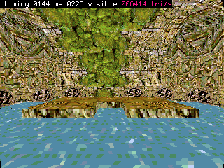

Finally got around quirks and implemented mip-mapping :
I also optimized quite some part of the library as a part as a full overhaul of the poor rooting code - conversion to fasmg lead only good.
A simple vertex transform stand now at 1600 cycles - or about 30000 vx/s at 48Mhz, which sound more than reasonable

Had some more time to resume the project a bit and play with it
Have some screenspace reflection goodies :

Judging from the screenshots, this is very impressive.
slimefolf wrote:
One step closer to DOOM.
Well at this point, this is more powerful than the doom engine. The fact that this can render whole meshes, and not use BSP maps, makes it a much more capable (although less optimized) engine.
