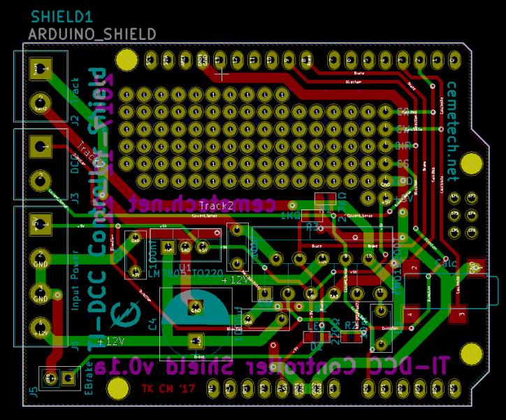

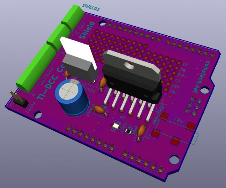

Unfortunately, I couldn't figure out how to override KiCAD's layer colors for the 3D preview (nor did the internet help), but here's the "final" version I sent to OSHPark shortly before Christmas:

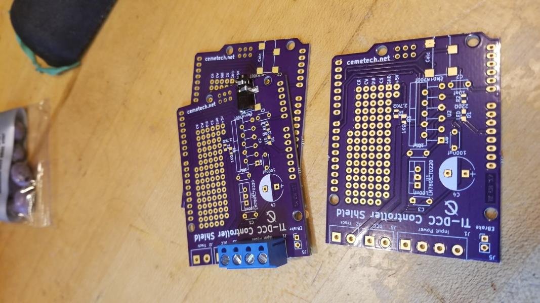

I also ordered a batch of parts from Digikey:
Code: Screw terminals ED2580-ND 4 @ $0.73 = $2.92
5V regulator 296-39011-5-ND 1 @ $2.01 = $2.01
10nF caps, radial BC2662CT-ND 3 @ $0.15 = $0.45
220ohm 0805 0.4W res RHM220KCT-ND 2 @ $0.10 = $0.20
2.5mm SMD jack CP-2523SJCT-ND 2 @ $0.96 = $1.92
2.7Kohm 0805 0.4W res RHM2.7KKCT-ND 2 @ $0.10 = $0.20
Clear red 0805 LED 732-4985-1-ND 2 @ $0.17 = $0.34
1Kohm 0805 0.4W res RNCP0805FTD1K00CT-ND 2 @ $0.10 = $0.20
100nF caps, radial 399-9870-1-ND 2 @ $0.25 = $0.50
1uF caps, radial 445-173583-1-ND 2 @ $0.32 = $0.64
Al elec 1mF 35V cap 493-1085-ND 2 @ $0.67 = $1.34
Stacking Arduino pins 1528-1074-ND 2 @ $1.95 = $3.90

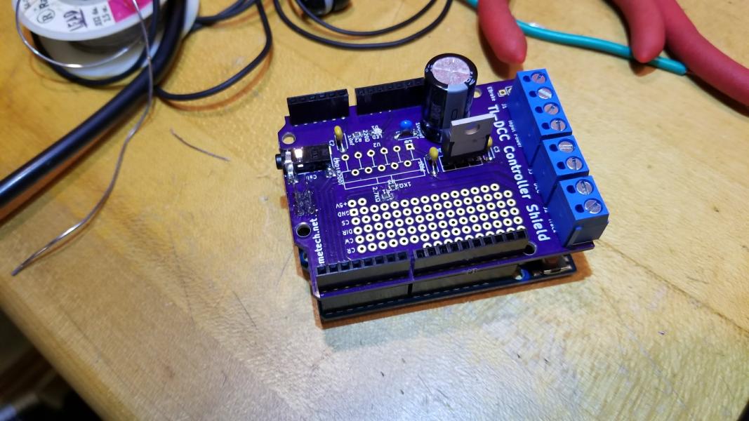

Got the last of my parts in today so here it is assembled!
Test by weeks end probably! Nights end
Train on idle, Click for full size.
I made a small mistake and forgot to make a logic ground for the control line coming out of the calculator. Not the end of the world just means I need to remember to hook it up. Though on a real setup the calculator would probably be wired to the 5v rail no the power connector. and there for could easily use the ground pin which would solve the problem.
Some minor changes made and pushed to
https://github.com/Cemetech/TI-DCC/ for my smaller board. I forgot some a ground pin as I said above. Fixed that and exposed the copper on the text, And added some silk screening for pinouts...because I kept forgetting
Makes it looks nicer :3

The assembled version looks great, and the fixed version looks great as well! Did the assembled one pass all of the tests? I see that the headlights on the train are on, but I assume it happily went forward and back as well? I think I shall nag you about DC mode, too, so you can test your new trains and I can test my ACS-64.
It functions exactly as expected
All tests passed with flying colors on my setup
