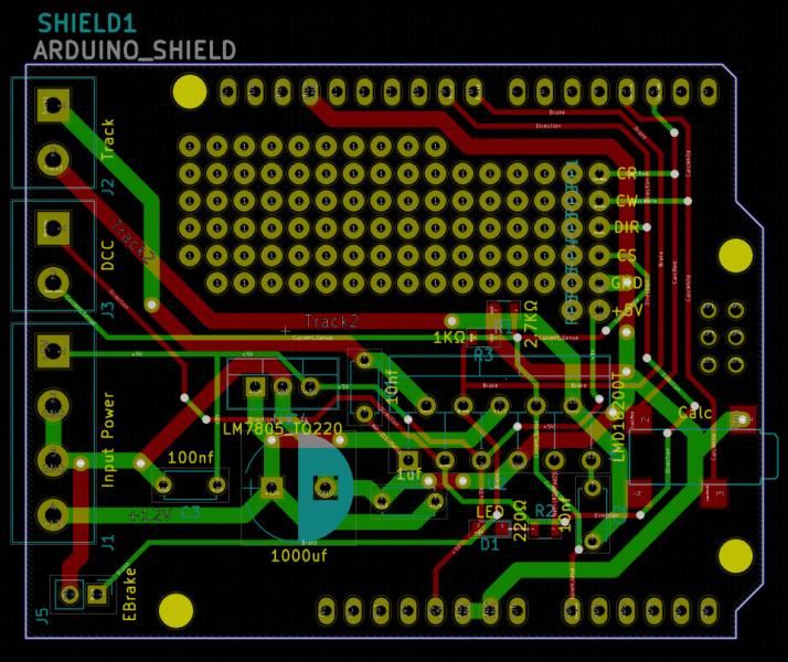

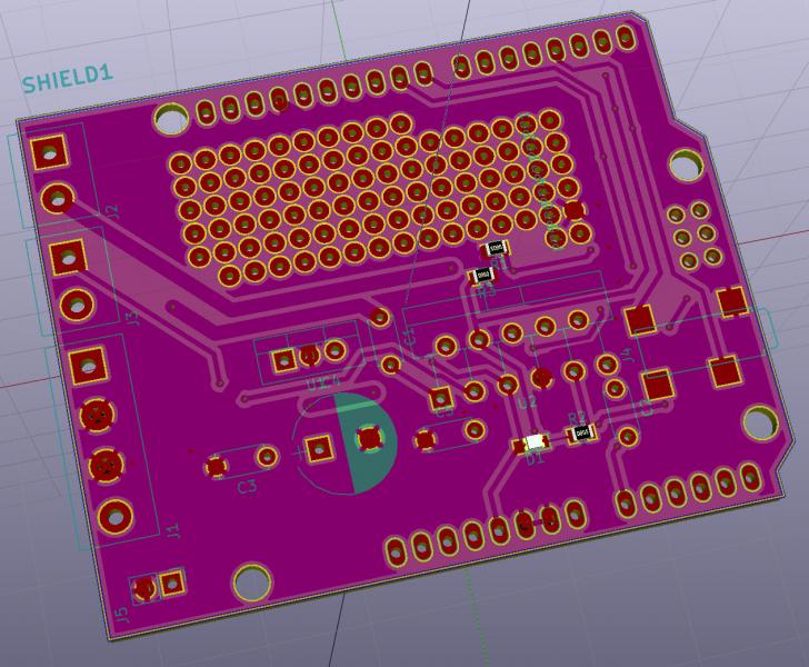

Current progress on my shield (sorry, I don't have as many fancy 3D parts loaded as Geekboy). I think really the only thing I'm missing is that silk-screened Cemetech C on it!
Geekboy1011 On IRC wrote:
[18:18:20] <geekboy> YOu should have definetily raytraced that 3d model
[18:19:02] <geekboy> minor groans still had. Mostly the anti stacking capabilities with leaving the lmd and lm7805 verticle
[18:19:08] <geekboy> HOWEVER much better all around
[18:19:16] <geekboy> I would still move D1 if possible as thast an easy fix
[18:19:56] <geekboy> I should thread this
