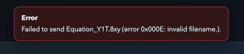

Hmm, the browser console dev might have more info already, but error handling (showing proper things back to the user) is on the todo list yeah.
In any case, you have:
TICALCS_ERR_NOT_READY = 257, TICALCS_ERR_BUSY = 269.
TICABLES_ERR_READ_ERROR = 3, TICABLES_ERR_READ_TIMEOUT = 4, TICABLES_ERR_WRITE_ERROR = 5, TICABLES_ERR_WRITE_TIMEOUT = 6.
Generally when those happen... something went rather wrong. disconnect the cable, reload the page, and reconnect the cable.
But also do tell me what led to this happening 🙂

Thank you so much! I don't know what led to it happening, though.

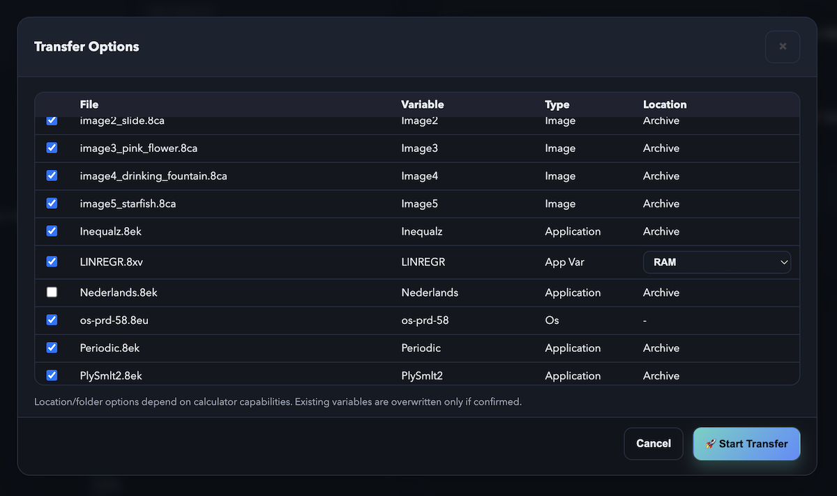

Fun part: here is the prompt that added Bundle support on first try:
Quote:
We want to add support for transferring CE "bundle" files. Those are .b83 / .b84 files (zip archives in reality, containing calculator files to be transferred), only targetting the TI-84 Plus CE family and TI-83 Premium CE family of calculators.
When a user wants to transfer such a bundle file onto their CE calculator, a special flow will have to be triggered in WebTILP:
1) Internally, get the list of files inside that zip archive (you can use the libarchive library that tilibs comes linked with, you'll just have to make sure to make the appropriate functions available to the JS via webtilp.cpp) and make sure to note the order of the files in this archive as it will be important afterwards. you can ignore the files called "METADATA" and "_CHECKSUM" inside.
2) Extract in some temporary location (maybe in a "tmp_bundle" directory inside the/a temp folder of the FS module provided by emscripten, probably) the files from the bundle (ignoring "METADATA" and "_CHECKSUM")
3) Display to the user the usual variable transfer modal, prefilled with the list of files from the bundle, in the order you determined in step 1. The difference is that the modal will have to have checkbox for each row of the list of files, because the user may want to skip some files to be transferred (by default, for which are checked and unchecked, see step 4). (The order is important, and the transfer will have to be made in this order too, with the exception of the OS files (.8eu and .8pu) that will have to be the very last transfer to be done, if the user has them picked/checked)
4) Here are the default file checking rules: starting from everything checked:
- if the CE calculator's device info has its "Python on board" property to "Yes", then leave "Python.8ek" checked (if present), and uncheck "PyAdaptr.8ek" (if present).
- if the CE calculator's device info has its "Python on board" property to "No" (or if it is not there), then uncheck "Python.8ek" (if present), and leave "PyAdaptr.8ek" checked if the connected calculator is the TI-83 Premium CE.
- for the language app files (Portuguese.8ek, French.8ek, Nederlands.8ek, Svenska.8ek, Espanol.8ek, Deutsch.8ek), uncheck all of them except for the ones present already in the device (check the dirlist if available), or the one matching the language of the calculator based on the first number value of the device info's "Language ID" property (for instance, the property value may be "9 1", the language ID will be 9). here is the lang mapping: 9=English, 22=Portuguese, 12=French, 19=Nederlands, 29=Svenska, 10=Espanol, 7=Deutsch.
5) If the user confirms, then do the transfers of the checked files, in the order of the list (except for OS files, that come last if picked)
6) Regardless, don't forget to clean up the temporary files/folders.

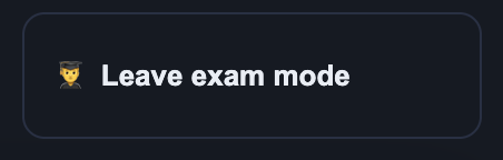

  • "Leave Exam Mode" button (similar to what TI's software does): supported on both CE/82AEP and TI-Nspire models.
    The Nspire will take a few seconds and then reset, that's normal - it might show an error in the page as it's resetting, but don't worry about it

  • Fix transfer error on some equation files on the 84+/CE series
