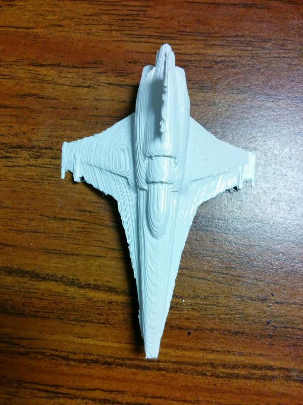

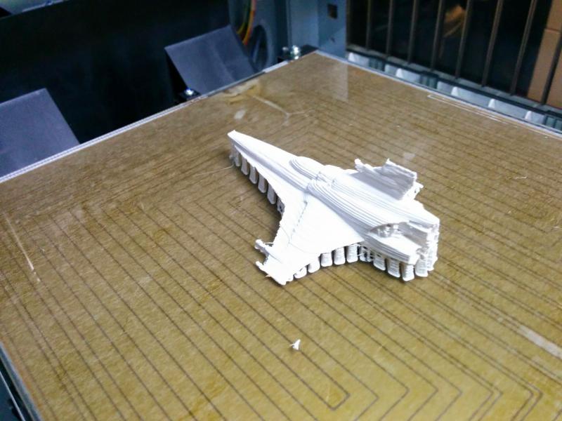

This evening, after discussing a broken model with Jonimus, I tried printing a (different) Viper model, unfortunately not of my own design. The Viper is a fighter space plane from the show Battlestar Galactica. I printed mine as a single piece, scaled down about 50% from the model's original size. It took 6 meters of filament and about two hours. As you can see, I used supports, but some of the edges were still too thin to come out well. In the second image, I have acetone-smoothed the right half of the model, but not yet the left.

That looks nice. Could it have possibly printed better if it were vertically? that way there might be less of the contours which happen when you print it flat.

This is a great idea. I'm printing this now, 50% larger and on its end. So far the only failure is that the backwards-sloping part of the top fin did not come out properly, because the supports underneath it were insufficient.
