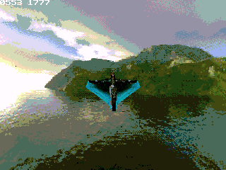

A starfox ship:
The starfox run @30fps, I miss the @60 fps by about 200000TStates.
Because ez80 power ' :
Hey, you made some progress! Can you tell us more about what you've changed and added, if this is still ASM, what you support (lighting? shading? what kind of texturing?), and how that skybox works?
Still pure asm, indeed Smile I've added support for clipping, affine texture mapping. It doesn't support shading, but perface lightning is doable (but only with flat filling). The skybox work the hardway, with a textured dome around the rotation point (sure, it is quite inefficient, but e don't have cubemap... ) Razz
